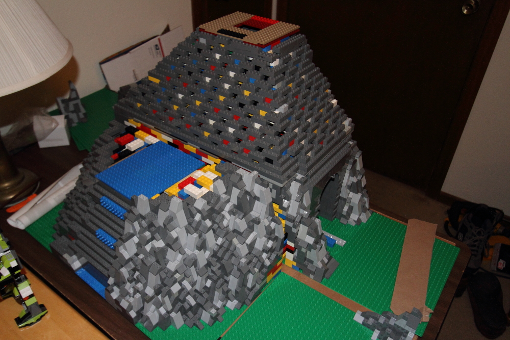

  • graphitegraphite Member Posts: 3,275
    @chuxtoybox
    Here is the current state of my mountain with train tunnel for my table setup. The colors are just what is visible of the 2x4 and 1x4 lattice structure that makes up the inside and will be covered in rock formation like the front is.
    khmellymelEKSamgifinimCCC
