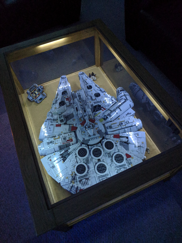

  • TokerToker Member Posts: 45
    This is what I've been working on. I just need to put it together so I can fit the top part on correctly.
    Oak wood all around. I used pocket hoIes to join the pieces. I routed a 0.25" track along all of the sides for the plexiglass. The pieces of wood in the middle are going to be used to join the top part.
    This is the removable top that will hold the glass.
    omniumKungFuKenny
    I was originally going to stain the wood, but I used chalk paint on a few other things and I really love how easy it is to apply and also how it looks. I'm going for a two color distressed look.
    The first two coats are Napolean Blue. The paint was still a little wet when I took the pictures. I used a gold metallic for the track where the plexiglass will go.
    The top coat is Graphite. The next step was to sand away a little of the paint to expose the blue underneath.
    TXLegoguy
    After distressing the piece in certain places, I applied wax for the top coat. I didn't distress the base of the table since I'm planning on doing a Lego desert landscape.
    You can see here the look I'm going for.
    BumblepantsLittleLoridmcc0pxchrisgmonkey76Addicted2Oxygenmadejp86TXLegoguy
    Put some LED strip lights under the top supports. Now just waiting for my Pick-a-Brick order to show up so I can finish the display.

  • MrJacksonMrJackson Member Posts: 454
    @Toker what kind of glass did you use? Does the side glass sit in a groove that I assume you used a router for? And how did you attach the top pane? Does your coffee table open? I'm doing something almost identical but with the awesome Docking Bay 327 for the interior. The glass is what's hanging me up so that's why I ask.
    I routed a groove in the top frame. The glass sits in the groove of the top wood frame. The glass itself was 0.25" thick and was the extra clear type. So far, it's been durable and has taken knocked over drinks, etc. The sides are plexiglass since I didn't need glass on the sides. It's also better since I have a dog and kids in case they hit the sides by accident.
    I used some decorative brackets to "center" the entire top. There's nothing else holding the top on except for it's weight. Since it's heavy, it doesn't move and the brackets also keep it in place.
    If I did it all again, I probably would have torched the whole table and applied a grey or sterling stain. This is a bench I did with a honey maple stain.

    @Toker how much did that .25" glass piece cost? I have plenty of Lowes and Home Depot gift cards to use for the wood so I'm more worried about messing up while staining once everything has been cut and routed than I am the cost of the lumber. I assume that glass top is the most expensive component? Just wanted to know how much I should be prepared to expect.
    Also, that bench looks totally awesome.
    The glass top was about $125 at a local shop. That was including the extra charge for better clarity.

    ^ That’s amazing!
